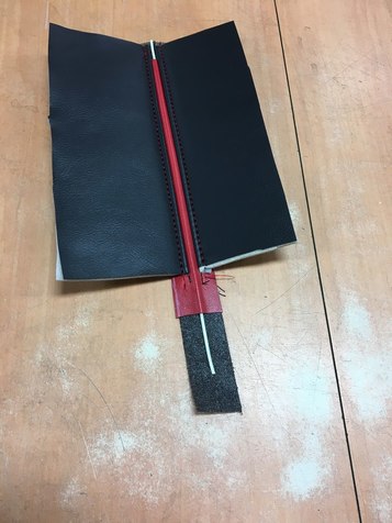

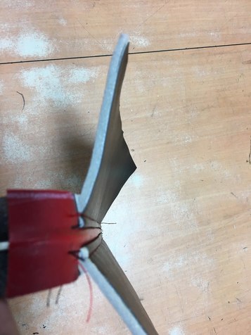

I have been trying to duplicate the piping/accent strip between the French seem in the photo. The problem I am having is getting the accent to not protrud above the side material. Does anyone have a good technique?
glue a thin piping welt to a flat base of material then glue your piping vinyl over top. Sew your facing vinyl to each side then top stitch. If you find its still too high, after gluing piping welt to the flat base material ,glue base material to each side of welt. This will sink your welt deeper.
Eric Gordon do you have any pics of this? Im terrible reading and visualizing. I realize there is more than one way to skin a cat so I’d like to see your method along with the way Brian showed
