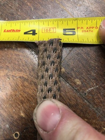

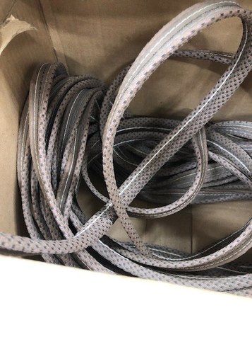

  • Roy Keith Powell
    6
    I have some antique cloth wire-on I purchased many years ago for a 37 Chevy. It is a taupe color. Folded it is 5/8" I don't know if the pictures will upload but I can email or text them to you. My email is
