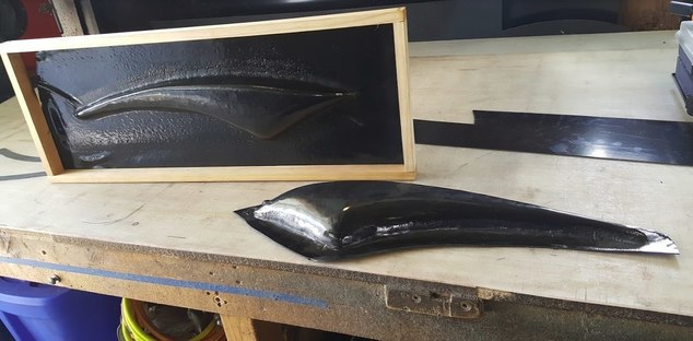

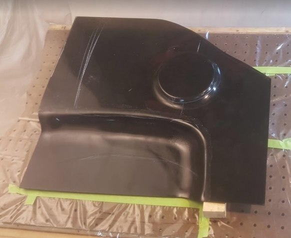

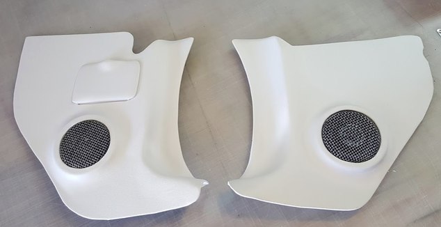

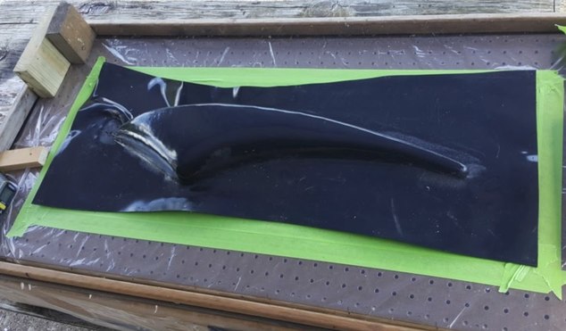

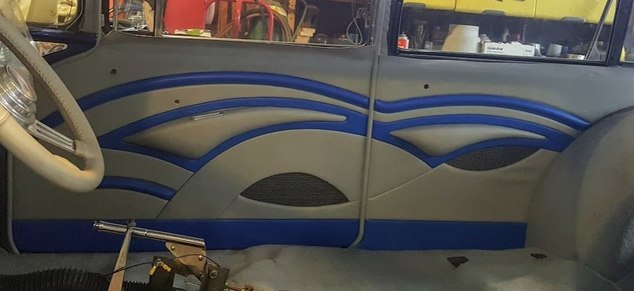

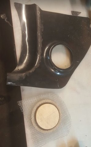

    The versatility of the ABS is hard to beat. It is also very easy to work with. Score and snap or use hand or electric tin snips to cut. I'ts easy to drill, will hold staples well, heat and shape (thermoforming). If you bend to far like 45° without heat it will snap. So just use a propane torch to slightly heat up the bend area. Around here a 4X8 sheet of .090 is about $35. If you mess around with it enough you can make some pretty cool stuff wftztvpfz33usxs2.jpg

    That's awesome Andy! I can't believe you were able to bend and shape the plastic like that. Very cool
  • Krunoslav Nakic
    5
    that´s a cool idea....was it vacuum formed and heated?..to me looks like that...so in that case build a wooden sample and vacuum form it over....
  • Andy Laird
    43
    Yes heat then vacuum. I just built a vacuum box out of wood and used pegboard for the top then a shop vac inside with the switch wired through the box, along with exhaust port. The vac could easily be outside, also wouldn't need to wire in a separate switch. Eventually I plan on building a heat box/oven to be able to control temp of the ABS, but for now I just use my acetylene torch, or a big propane weed burning torch to heat the ABS. Its real hard to control the heat that way though.
    And yes a wood sample to form over, or carve styrofoam wrap it with plastic wrap and a layer of fiberglass over that. At that point you could just make it with the fiberglass but that is a lot of mess and expense in matting and resin. In either case the heat of the thermoforming or resin chemicals will melt the styrofoam. Wood is a better model but foam is much easier to carve.
