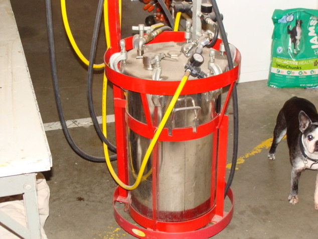

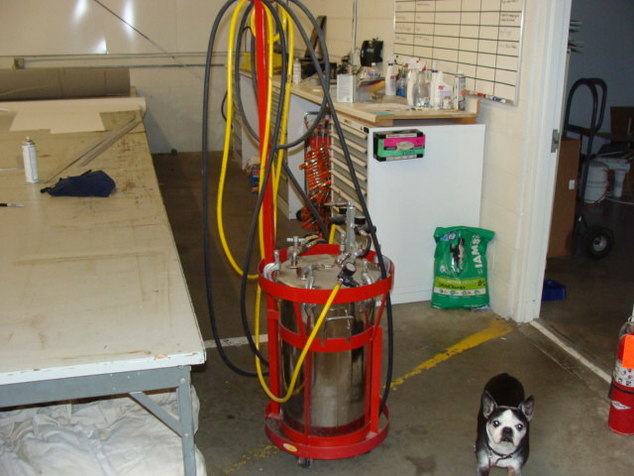

    I purchased this 5 gallon stainless steel pot on craigslist for $50 bucks. It was dirty and full of paint I had to strip off. I had to purchase all the valves, gun, hose and mechanicals for it. I made the cart and hose rack.
    I poke a hole in the top of a 5 gallon bucket of glue and put the whole thing inside and put the lid with tube in the glue bucket. It takes 5 minutes to change pails. there is a pot liner in it but I have never had to change it. I have about $800.00 into it.
    The gun has great control and can put a lot of glue down or very little at a pinpoint. You can put the spray head anywhere and no cup to spill. it is Graco brand everything.
    The first glue hose i had was made of rubber and the solvents in the glue would dry out and plug the gun. I switched to a plastic and that stopped. It has a Graco 289992 AirPro gun.

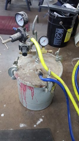

    9
    My first one was a Craftsman 2 gallon paint pot. I purchased the airline and fluid tube from our upholstery supplier. Purchased a second gauge and regulator for out going pressure regulation. And I bought the gun from Big Lots. That setup was 10 times better than the binks i have now. Js

    so im just about to commit and have 2 questions I need answering ??
    what size needle ?? 1.4 or 1.8
    does it have to have valve and gauge 1 for input and 1 other for output or is just the 1 ok ??
    if not and pot only has 1 is it fine to use the remote one that fits just before gun ?

    You'll want 2 separate regulators. The first with 2 outputs, output one will go to your glue gun air intake, output 2 will go to the secondary regulator, then the glue pot itself. Your main regulator the one you connect to your air compressor can be for normal shop air pressures. Your secondary regulator ( the one that regulates pressure on the glue pot) needs to be low pressure capable. Most regulators don't have low pressure capabilities I've been using this one with good results
    I don't have the info in front of me but I think the highest tank/pot pressure should be no more than 13 psi. I run mine around 8 psi. when spraying thin foam glue (Dubois 301)

    I built my own glue pot system, but with harbor freight paint pot The regulator from this paint pot system works well enough, just add your secondary regulator underneath, add a pressure relief valve, and another gauge so you can read the pressure on the tank, The most important part of the whole system is the relief valve. Just be safe!

    That one looks fine but you will still need a separate regulator for the tank as explained above. if you have too much pressure on the tank it will force glue through the needle guide and make a huge mess everywhere.
    I honestly don't the needle size will matter much. but I would go with the larger one. I think most of my guns are 1.8
