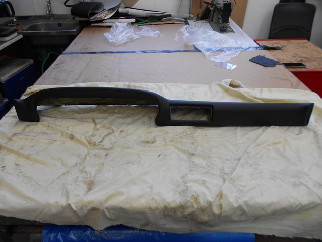

    I'm just about to cover a few porsche dashboards, no problem doing them as I've done several before but I now have a skiving machine to use.I normaly add a seam along the edge of the dial area to aid fitment this I add a french seam to, previously I've left the leather full thickness in the seam.Now I have a skiving machine I wish to thin down this area but don't know how far in to skive , I use 10mm seam allowance so should I skive 9mm so the seam is on full thickness with the thinner area to fold over, skive 10mm so the stitch is on the skived area or 20mm so the seam is skived and both the top and bottom of the topstiched part is skived?

    Well I had a bit of a play today as I had to get on with the dashboards and came to the same conclusions as Lee but I hammered the seam down before top stitching.However when I did the dashboards I didn't bother skiving as the way the seam sits the extra thickness isn't visible.I'll post a pic when I've finished. I do have other stuff coming up that I will need to skive the edges on though.

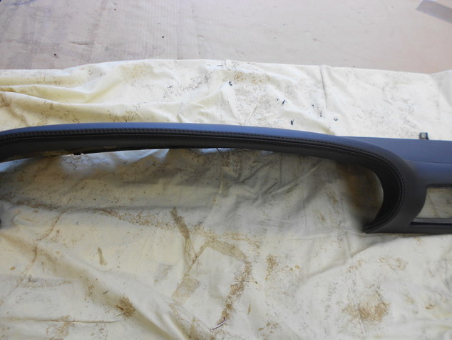

    So your saying skive at about 8mm to allow for 4mm on each side of the fold and give enough room for a top stitch or 2mm skive, 1mm each side and top stitch only one layer of leather.I can see what you mean by an even skive, I just see what the eastern europeans on instagram can do and try to get closer to it, they seem to run their skiving machines at a really slow speed and get such a neat even cut.I need to have a play and a bit more adjustment though.
    Pic of completed dash.
