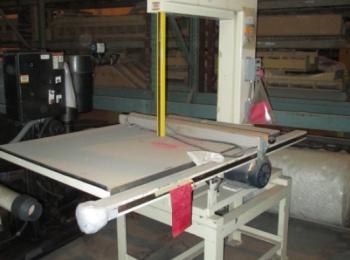

    At the upholstery shop where I work an industrial fabric cutting machine is used to cut foam. These are usually used to cut garment parts by stacking multiple layers of fabric and cutting the pattern. It is in some ways a much larger version the Bosch foam saw. It is much more stable and cuts reasonably fast. If you are cutting large pieces of foam you should look into one.

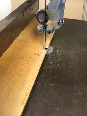

    My favorite tool for cutting foam is the bandsaw. If you are cutting geometric shapes this is the tool! It is fast cutting and leaves a nice finish. If you need to cut an angle you just tilt the table. Using a fence, it is easy to cut parallel lines. Finally, this may be the best, you can glue foam to a plywood/plastic base and easily cut the foam leaving an overhang. Here is how you do it. Make a temporary fence out of wood the same or less then the thickness of your backing material. Cut a notch in it so the fence can extend past the blade. The base runs along the fence let’s say ¼”, for example, from the blade. The blade cuts the foam a perfect ¼” from the base material. I will post a picture to make it clearer.

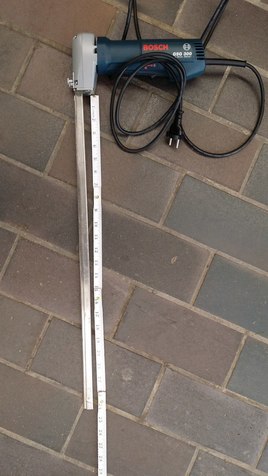

    Its a regular product (no bosch OEM - but also high quality) i can get from some of my supplier. I bought it years ago for cut off the foam of bigger motorcycle seats. But last year i get sick of changeing the blades so i bought the second gsg300.
    I will make some pic and check out the price for it tomorrow.
  • Jens Jesberg
    50
    I am a liar or rather i dont know my tools exactly :-! I just got the 24" blade. :D But a 31" is available.
    I got 2 suppliers Diekraefe and Binder. The prices are nearly the same. If somebody is interested in an order I can manage a order if there are problems with language or international shipping. bcod5kapq7uuones.jpg

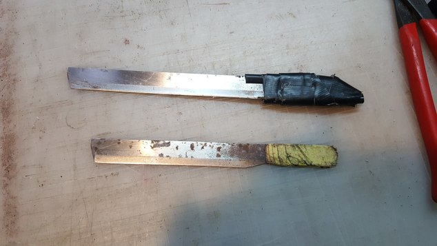

    I used an electric knife for years and finally broke down and bought the Bosch. I should have done that form the beginning, its my go to for foam. I do have an electric straight knife like the picture in the first post but I almost never use it (for foam anyway). Its a large powerful machine but a bit awkward to use, especially with a chain-mail glove. I do use the blades however, they work awesome for smaller freehand work. I'll add a pic. its basically an 8" razor blade. If interested you can buy them here http://www.allbrands.com/categories/1915, or just do a search for 8" straight knife replacement blades.n21i3tusbpxaeppf.jpg
